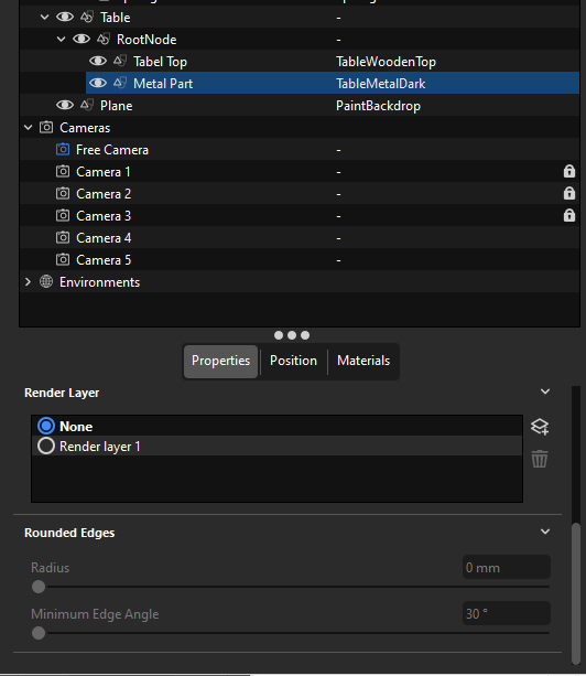

I’m totally confused but suddenly the Rounded Edges are greyed out. First I thought it was maybe my scene but a new scene with a default cube gives me the same? Who has the winning answer?

My rounded edges options come and go as they please, its not consistent, but more often than not, it is greyed out. Almost seems that if I have KS open for more than 10 min , after that it is greyed out. Now since updating to 2023, it is 100% greyed out, cannot get it to work no matter what.

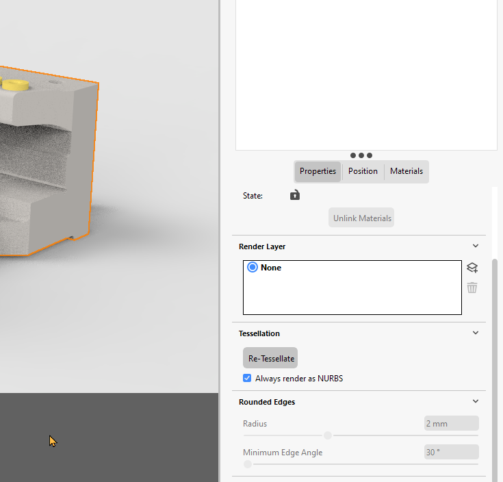

@oscar.rottink - I’ve yet to try this in KS 23, but I’ve encountered this at random in KS 11 Pro and the workaround I found was to to tick on and off “Render NURBS” on the toolbar. This has worked for me every time as far as I can remember to get the rounded edges options out of doom grey.

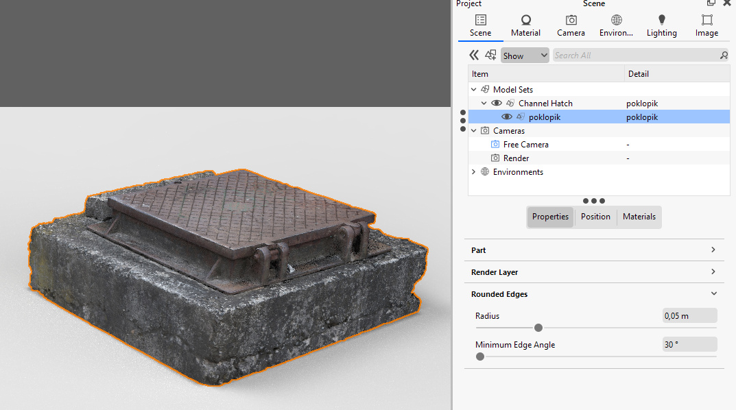

Regular rounded edges works if the scene contains NURBS data or not.
In NURBS mode, rounded edges will be deactivated in realtime render port, but the input value and slider are still active.

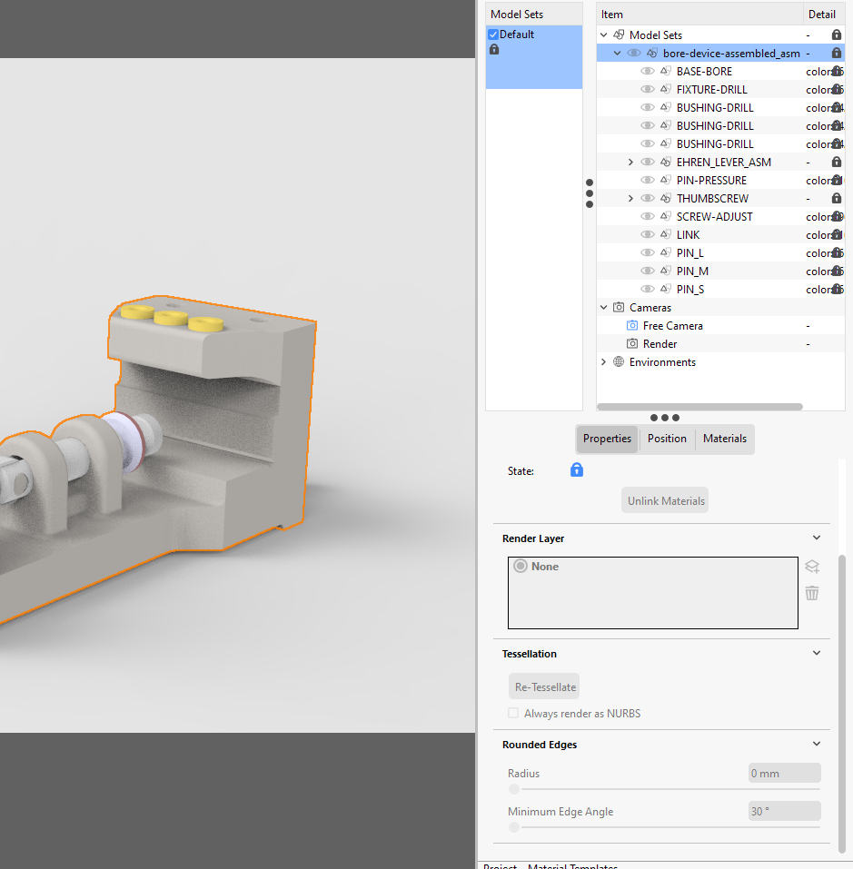

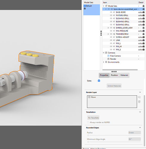

If the part is locked, the rounded edges value (and slider) are “greyed out”. So please try to lock and unlock these parts

Any solution here? I’ve experienced this continually for years with no rhyme or reason. The NURBS on/off toggle works usually, but only if it is present. Some parts do not have NURBS as an option (I get most of my 3D models from clients, so I almost never am creating models and maybe the issue is related to the type of file I receive – almost always STEP files), so it seems that if the choose to be grayed out, they stay grayed out no matter the action.
It works as always. To force the radius option greyed out you can:
